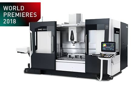

DMC 1850 V
WITH ITS HIGHLY STABLE MACHINE BED AND THE OPTIONAL 288 Nm SPINDLE, THE DMC 1850 V IS IDEALLY SUITED TO HEAVY DUTY MACHINING
NHX 4000
DMC 1850 V HIGHLIGHTS
  • One-piece machine bed for heavy-duty cutting with up to 288Nm
  • inlineMASTER, speedMASTER and powerMASTER spindle up to 20,000 rpm or up to 288Nm
  • 36 months warranty on all MASTER spindles with unlimited running hours
  • 2,160 ×750mm table for processing large workpieces up to 3,000kg or unattended machining of many small workpieces
  • 5 μm circularity and thermal stability through comprehensive cooling and smartSCALE measuring system from MAGNESCALE
  • CELOS with SIEMENS or CELOS with HEIDENHAIN (TNC 640)
